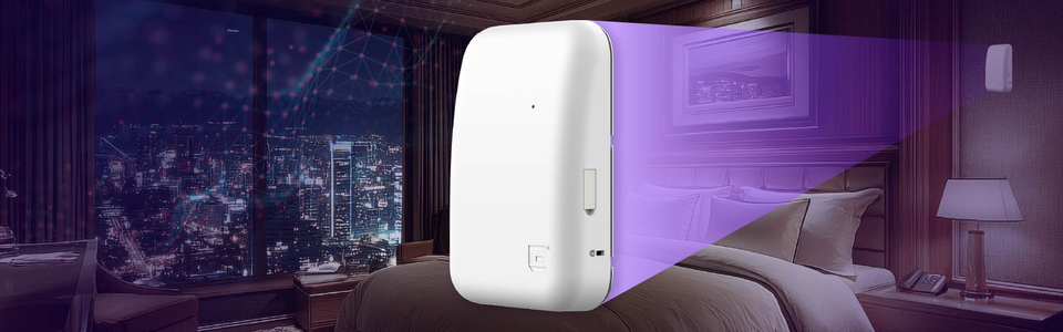

The Extreme Networks AP3020W access point is purpose-built for these environments, bringing enterprise-grade Wi‑Fi 7 connectivity to individual rooms in a compact, sleek wall-mounted form factor designed to blend naturally into the room while balancing performance, functionality, and affordability. The AP3020W combines Wi‑Fi 7, wired connectivity, and integrated IoT capabilities with centralized management in a solution designed specifically for hospitality, healthcare, education, and residential installations.

The AP3020W was designed specifically for these deployments. Its compact wall-mounted design delivers enterprise-grade Wi‑Fi 7 performance while fitting naturally into guest rooms, patient rooms, residence halls, and apartments.
But in these environments, performance is only part of the equation. Aesthetics matter too. Hotels, luxury apartments, senior living facilities, and modern student housing need technology that complements the room rather than becoming a visual distraction. The AP3020W’s sleek, low-profile industrial design allows it to blend naturally into the room while delivering enterprise-class connectivity behind the scenes.

One of the AP3020W's most compelling advantages is its ability to deliver full Wi‑Fi 7 functionality using standard 802.3af PoE power. By eliminating the need for higher-power infrastructure in many deployments, organizations can modernize room-based connectivity more cost-effectively while preserving existing investments.
The AP3020W also combines a 2.5 Gbps uplink, three downstream Gigabit Ethernet ports, and an RJ45 pass-through connection to support in-room technologies such as IPTV systems, IP phones, cameras, gaming consoles, and more. Where 802.3bt PoE is available, the AP3020W can also provide 5W of USB power and 15.4W of PoE output to power connected devices directly from the access point, helping reduce cabling requirements and simplify deployments.
The AP3020W also incorporates dual IoT radios with Bluetooth Low Energy (BLE), Zigbee, and Thread capabilities. This enables organizations to support smart room services, automation initiatives, asset tracking applications, and future IoT deployments without additional hardware.

The AP3020W expands Extreme's Wi‑Fi 7 portfolio with a solution designed specifically for room-based deployments. Its flexible dual-radio 2x2:2 architecture can operate in either 2.4 GHz + 5 GHz or 5 GHz + 6 GHz modes, giving organizations the flexibility to match the radio configuration to their deployment requirements. Organizations can deploy purpose-built access points where they make the most sense while benefiting from the same architecture, visibility, automation, security, and management experience across the network.
