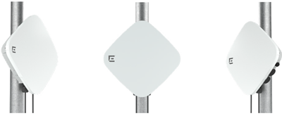

Universal APs Outdoor
AP5050U/D
Wi-Fi 6E Tri-Radio IP67-Rated Outdoor Access Point

The AP5050U/D is a family of purpose-built 802.11ax (Wi-Fi 6E) Access Points (APs) for Stadiums that support more users and IoT devices with greater performance and efficiency.
The 6 GHz radio is enabled outdoors in the United States and uses Automated Frequency Coordination (AFC). 6 GHz AFC ratification and certification varies by region.
Key Benefits Include:
Harsh Outdoor and Stadium Optimized: As the Official Wi-Fi Solutions Provider of the National Football League (NFL) and Major League Baseball (MLB), Extreme understands firsthand the unique challenges of stadiums and harsh outdoor high-density Wi-Fi deployments. The IP67-rated AP5050 Series builds on that experience, by delivering a custom-designed family of access points that cater specifically to these types of challenging environments.
High Performance in High Density Environments: Improve user experience and device performance with 4x4:4 6 GHz, 4x4:4 5 GHz, and 4x4:4 2.4 GHz with OFDMA technology. With the latest Wi-Fi 6E performance and multiple software programmable radio modes, AP5050 series can serve the densest environments.
Future-Proof with Wi-Fi 6E: With built-in 6 GHz radios, Extreme AP5050 series increases device capacity and improves spectral efficiency, allowing stadiums and high-density environments to extract more out of the Wi-Fi spectrum and future-proof their network and investment. The AP5050 series comes with multipurpose GPS capabilities, allowing it to detect regional location for approved Wi-Fi 6E outdoor use.
Modular Design for Flexible Deployment: Extreme’s experience has taught us there is no one-size-fits-all solution for stadiums and complex outdoor environments. From the field to bowl seating, to gate entrances, to concierge areas, to parking lots, temporary medical sites, or outdoor campus locations, each area has its own requirements. The AP5050 series delivers flexible deployment options—from under seat mounted, to pole-mounted, to APs with software selectable antennas—that ensure an exceptional mobile experience throughout the entire stadium or deployment environment.
