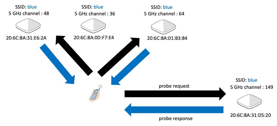

Wi-Fi clients have traditionally used an active hunt-and-seek method to scan for access points (APs). Clients send out probe request frames across the 2.4 and 5 GHz channels to discover APs. The APs respond with a probe response frame which contains all the necessary information for a client device to learn about the parameters of the basic service set (BSS). For example, the AP’s channel size, SSID, BSSID, security parameters, and much more.
Wi-Fi clients use an active scanning method to send probe request frames across all available channels by the client device. If a client receives probe responses from multiple APs, the incoming signal strength, SNR, and other metrics are typically used by the client to determine which AP has the best signal and thus which AP to connect to.
A client will sequentially send probe requests on each of the supported channels. In fact, it is typical for a client already associated with an AP (and receiving data) to temporarily go off-channel and continue sending probe requests every few seconds across other channels. The primary purpose of off-channel probing is so that a Wi-Fi client can find other APs to potentially roam to.
Figure 1 – Client probing
In the example in Figure 1, the client is already associated to the AP on channel 36. However, the client actively scans and sends probe requests across multiple channels, and other APs will send their information via probe responses. Wi-Fi clients use probing to maintain and update a list of known APs, as shown in Figure 2. In this example, the client has discovered three other APs to which it might potentially roam. This “known AP” list is constantly updated by active off-channel scanning. The roaming thresholds for client devices are proprietary; however 802.11k neighbor information may be used to influence the client's roaming decision.
