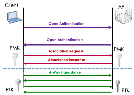

Traditionally, Wi-Fi hotspots and guest WLANs have used open security without encryption or authentication. (Although Passpoint security is catching on fast in the Wi-Fi public access marketplace). The Wi-Fi CERTIFIED Enhanced Open certification defines improved data privacy in open Wi-Fi networks. This certification is based on the Opportunistic Wireless Encryption (OWE) protocol. OWE is defined in the IETF RFC 8110. The OWE protocol integrates established cryptography mechanisms to provide each user with unique individual encryption, protecting the data exchange between the user and the access point. As shown in Figure 2, standard open authentication and association occur, and then the 4-Way Handshake process generates the necessary keys for encryption.
Figure 2 - Opportunistic Wireless Encryption
The OWE experience for the user is the same as open security because there is no need to enter a password or passphrase before joining the network. Data privacy is provided, and malicious eavesdropping attacks are mitigated because the 802.11 data frames are encrypted. But please understand that there is zero authentication security. Enhanced Open is not part of WPA3 and is an entirely different and optional security certification for 2.4 GHz and 5 GHz frequency bands. There are two modes of operation for OWE:

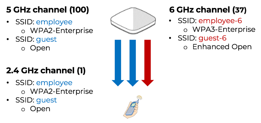

  • Because the existing 15 billion Wi-Fi clients will never be able to connect to 6 GHz, it appears likely that different levels of security will be used on the different frequency bands in the enterprise. WPA3 will indeed be used in 6 GHz. Yet, despite the support for WPA3 transition modes in the legacy bands, WPA2 will likely remain prevalent in the 2.4 GHz and 5 GHz bands for a very long time.
  • This means that different SSIDs with different levels of security will be used on the various bands. For example. As depicted in Figure 3, an employee SSID using WPA2-Enterprise and a guest SSID using open security are used for the 2.4 and 5 GHz bands. However, the 6 GHz band requires different SSIDs and security: employee-6 using WPA3-Enterprise and guest-6 using Enhanced Open.
Different SSIDs and Security across three frequency bands
Figure 3 - Different SSIDs and Security across three frequency bands
One potential drawback of this scenario is that it prohibits intra-band roaming. A newer Wi-Fi 6E client can potentially roam between all three bands if the same SSID with the same security is used. Intra-band roaming is not always a good thing; segmenting users by frequency band often has advantages. However, if intra-band roaming is a requirement, a WPA3-only SSID could be deployed across the bands, while a WPA2-only SSID could still be offered on the legacy bands.
